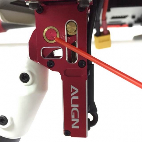

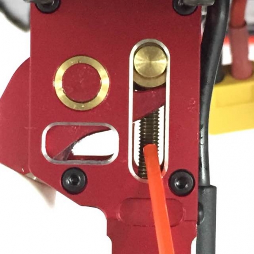

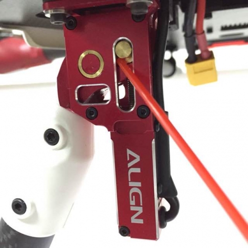

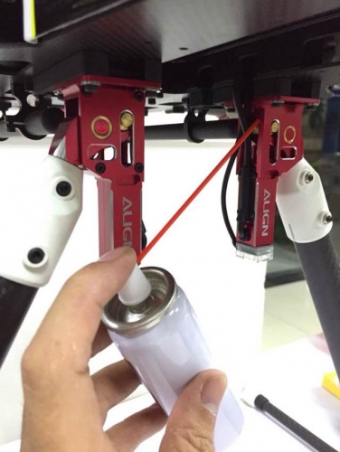

    2. To ensure smoothness of the retracts, periodic maintenance must be performed.
    First blow all dust and debris from the internal jack-screw with a can of compressed air. Then spray with non-stick lubricant on jack-screw and all movement joints. Wipe away excess lubricant from exterior surfaces when done.
