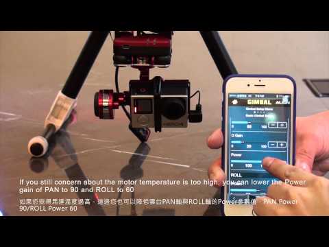

    2.During long time standing or steady system adjustment on the ground after power on G2 gimbal, the motor temperature of PAN and ROLL will be little higher, but this will not affect gimbal function and service life. If you still concern about the motor temperature is too high, you can lower the Power gain of PAN to 90 and ROLL to 60. It can cooler motor temperature of PAN and ROLL effectively and can shoot a nice video as well.
