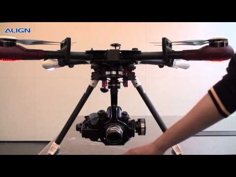

    There are several reasons could cause Tilt arm level position with multicopter. There are several reasons could cause this happen, but it’s not
    1. Before ROLL arm horizontal adjustment, make sure to loosen the housing set screws on ROLL arm firstly; then when tighten the housing set screws, make sure to push up Tilt arm at level position.
    2. Originally, the gimbal anti-vibration plate is fully level with multicopter itself, but dampers are mounted between anti-vibration plate and Tilt arm, while damper is soft connection and may cause bank angle for Tilt arm if PAN C.G. is not set correctly.
    3. The ROLL arm is made by aluminum, any collision or impact will make the imbalance even worse.
    4. There are four screws on Tilt arm and ROLL arm allow you to adjust Tilt arm balance.
