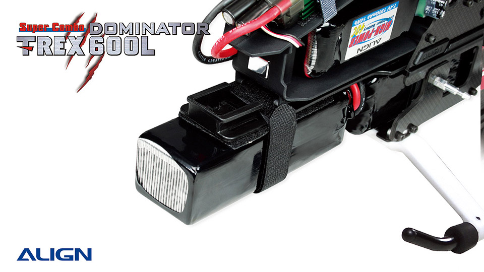

Sliding battery tray rails imbedded into 3K Side frame.
