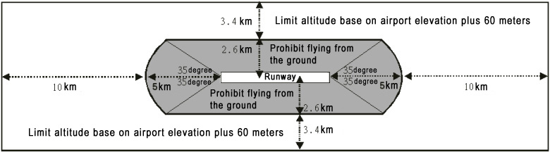

Answer: A. The prohibited airspace is calculated based on the runway. It is centered on both ends of the runway, with a radius of 5 km and an arc of 35 degrees to the left and right. And from the left and right sides of runway center line, the area covered by each 2.6-km area which is slightly shaped like an oval.
B. Moreover, based on (A) prohibited airspace, from the central of both ends of the runway, extending another 10km at a radius of 5 km outwards; and extending another 3.4km from the centerline of the runway at a distance of 2.6 km outwards like a square. As a huge rectangle shape starting from 60 meters high or more where it is forbidden to fly obstruction to aircraft.
C. Please refer to the following diagram. The oval area is the prohibited airspace to aircraft. And the huge rectangle area is the prohibited airspace with 60 meters height or more.
Prohibited Airspace near the Airport Diagram

Take Taipei’s Songshan Airport as an example. Dajia Riverside Park, Xinsheng Park, and the Zhongshan Football Stadium are the places in prohibited airspace area which is forbidden to fly objects from the ground completely. The Sun Yat-Sen Memorial Hall, Taipei City Government Square, and Taipei 101 Building are the places in prohibited airspace area which is forbidden to fly objects from 60m height of Taipei’s Songshan Airport.
B. Besides, you can check the information from geographical systems, such as Google Earth. It can be used to roughly measure the distance between your aircraft home position and the airport runway centerline nearby. Take Taipei 101 as an example, in Google Earth, the straight line distance from Taipei 101 to the centerline of Taipei Songshan Airport runway (28 runway end) is about 4 km that is the place in prohibited airspace area which is forbidden to fly objects from 60m height of Taipei’s Songshan Airport elevation.
